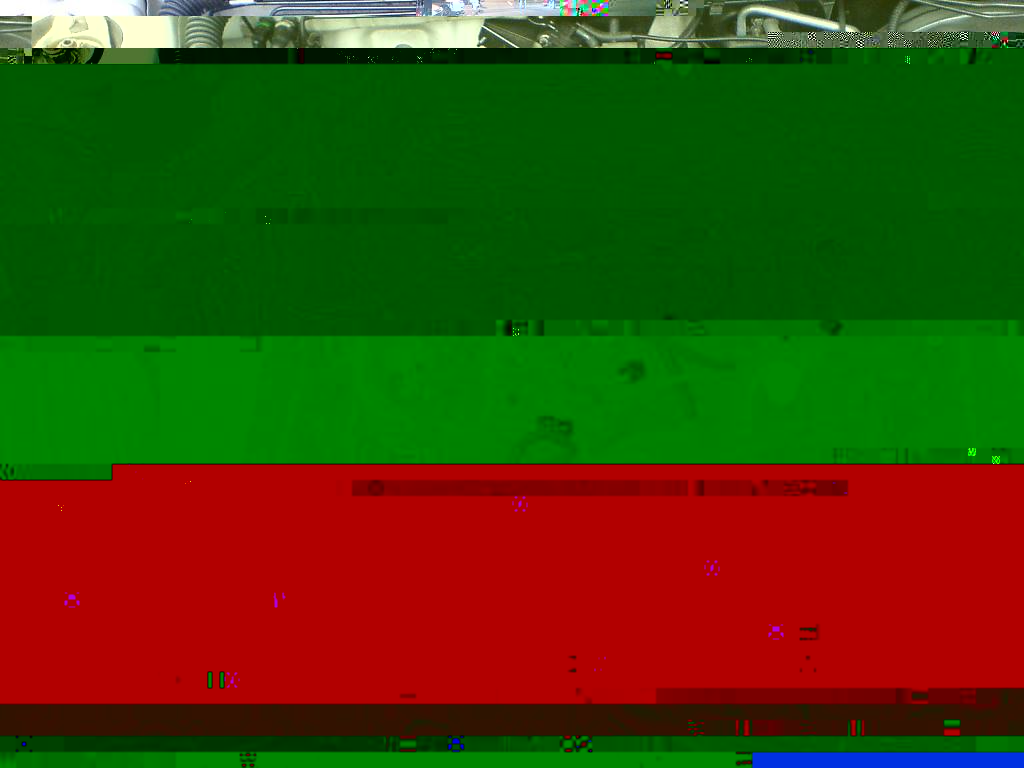

si ultima poza, mandria mea!!!Peugeot 406 2003, 2.0 HDi, motor RHY
