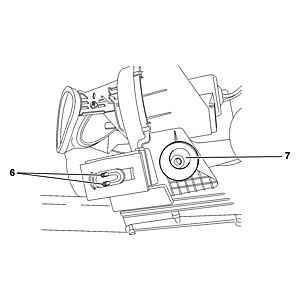

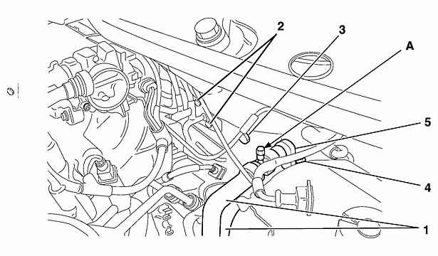

                  C5HG18K1 REMOVAL - REFITTING : HEATER
                  1. Special tools
                  Figure : C5HF0C4C
                  [1] Hose clamp (-).1512.
                  [2] Pliers for spring collar (-).0165.
                  2. Removal
                  Figure : C5HF0C4D
                  Depressurise the cooling system (At (A)) .
                  Clamp the matrix inlet and outlet hoses Using the tool [1]) .
                  Disconnect the hoses (1).
                  Drain the cooling system.
                  Remove the bolts (2).
                  URGENT : Quickly close the air conditioning pipes so that they are sealed.
                  Remove the bolts (3 - 4).
                  Release the inlet and outlet pipes clamp (5).
                  Remove the fascia .
                  Figure : C5HF0C5D
                  CAUTION : Place a receptacle under the heater matrix inlet and outlet pipes.
                  Check that all of the fascia harness wires are disconnected.
                  Pull the air conditioner towards you and remove it.
                  3. Refitting
                  Figure : C5HF0C6C
                  CAUTION : Check that the fasteners (6) and the expandable mounting (7) are present before refitting the air conditioner.
                  N.B. : Do not forget to reposition the plastic spacer (7) between the bulkhead and the expandable mounting .
                  URGENT : Reposition the drain hose in the hole on the front floor before fitting the air conditioner to the bulkhead.
                  URGENT : For the air conditioning circuit, reconnect all the unions fitted with new seals, lubricated with SP10 type compressor oil.
                  Proceed in the reverse order to removal.
                  N.B. : Lastly tighten the bolt (3) on the expandable mounting .
                  Charge the refrigerant circuit.
                  Fill and bleed the cooling system.
                  Check the operation of the air conditioner.
